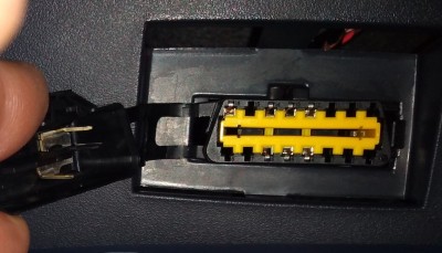

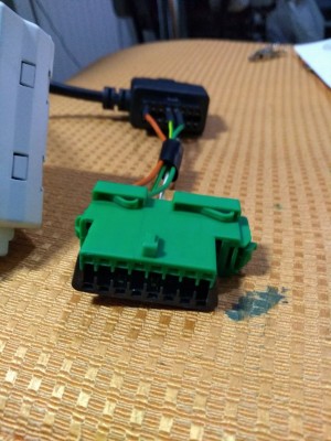

Do you mean the bridge between PIN 4 and PIN 5? It does not matter. These PINS connect with the car's body anyway.
No, I have inside the cover of the OBD2 port 2 pins connected together, see into your cover, later I will post a picture, many thanks again.
Pomógł: 118 razy
Posty: 4015
Wysłany: 2020-01-22, 10:07
effesse72 napisał/a:
I have inside the cover of the OBD2 port 2 pins connected together, see into your cover...
OK - I already know what you mean. There is no difference. The cover can be closed or open - BIC will work. At the beginning I also used BIC connected to a normal OBD plug.
The bridge in the cover connects unused pins...

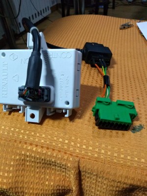

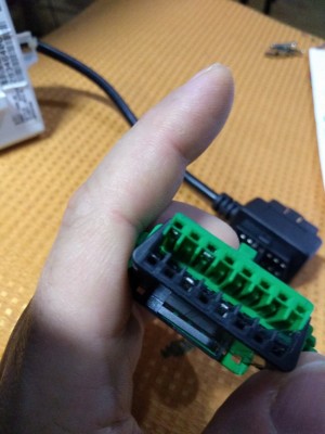

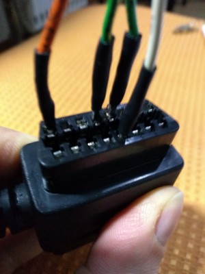

...but it seems to me that there is a bridge between the Pin No. 16 and the Pin No. 6 and for me it's not normal to short the +12Vcc to the CAN Bus :shock:
By the way Dymek, if I will strip the wires, as you did in your previous photos, to solder 6 wires on those that carry the signals to the ODB2 socket, is it better to disconnect the battery of the machine to avoid burning some ECU? :-/ Thank you very much again for everthing, best regards, Stefano.

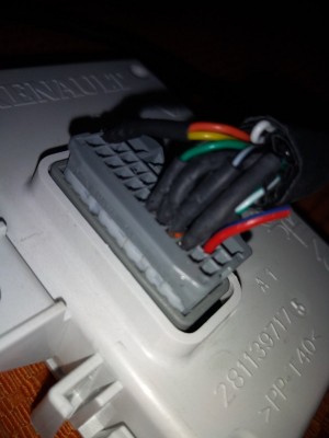

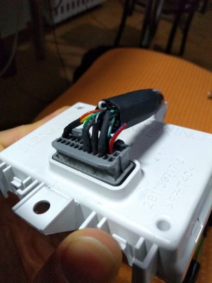

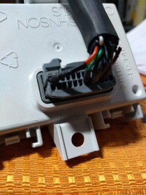

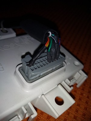

Hi Dymek, do you know where I can find the pinout of the 24 pin socket of the BIC?
I wonder if I have to feed some wires also from the Medianav Evo and other pins of the BIC.
Thank you so much again.
... if I will strip the wires, as you did in your previous photos, to solder 6 wires on those that carry the signals to the ODB2 socket, is it better to disconnect the battery of the machine to avoid burning some ECU?
It's always safer after disconnecting the battery. But I didn't disconnect the battery. I worked very safely - I soldered and insulated the wires separately, one wire and then the next wire ... etc.
Each pin was removed from the OBD socket to install the heat shrink tube because I didn't want to cut the wires.
That's why I stripped off all the cable insulation. :mrgreen:
I don't have the full pinout for the BIC module. I only know these 6 pins.

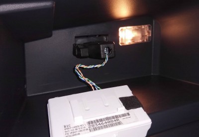

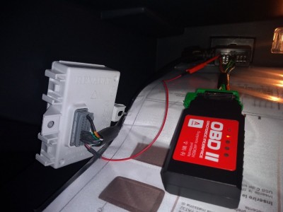

Btw dear Dymek, the connection to talk with the BIC using ELM327 (I'm using now a WiFi model with 18F25K80 chip) has to be only do to the ODB2 port in the glove box by means of 4 wires? 16, 4 (power supply), and 6, 14 (CAN signals) ? It will be enough to start DDT4ALL software, choose the ECU and go ahead until BIC A2/A3 v24 ? :roll:
Pomógł: 118 razy
Posty: 4015
Wysłany: 2020-01-24, 14:10
... the connection to talk with the BIC using ELM327 (I'm using now a WiFi model with 18F25K80 chip) has to be only do to the ODB2 port in the glove box by means of 4 wires? 16, 4 (power supply), and 6, 14 (CAN signals) ? It will be enough to start DDT4ALL software, choose the ECU and go ahead until BIC A2/A3 v24 ?
The connections between the ELM plug and CAN2 socket in the glove box must be crossed:
ELM PIN - OBD2 PIN
4 - 4
6 - 13
14 - 12
16 - 16
DDT4ALL Path: ECU Name - MIU - BICA2/A3v24 - Screen RDBI/WDBI - Configuration - Vehicle environment - Script 14
LINK
Ostatnio zmieniony przez Dymek 2020-01-24, 14:18, w całości zmieniany 2 razy

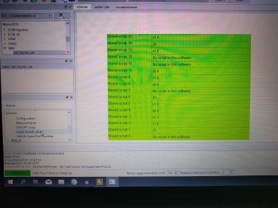

Good morning Dymek, today I'm trying this way:
The Pin 4 and 5 of the OBD2 port (the yellow and orange of the splitter) are soldered together and go to the Pin 12 of the BIC connector :roll:
Thank you very much again for all the support yu gave to me!

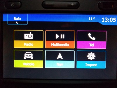

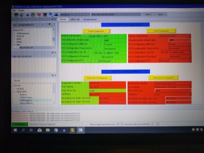

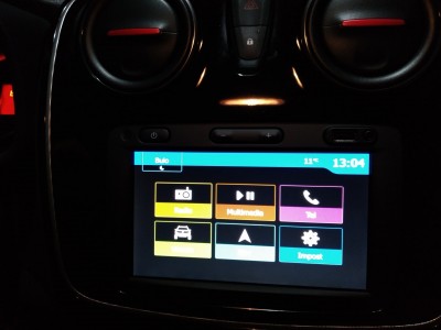

And finally..... I did it! I had to rewrite script 14 on the BIC also connecting Pin 2 to + 12Vcc. By connecting this Pin 2 to + 12Vcc I had noticed (see 3rd photo) that some data had already appeared on the Medianav Evo, but as the script 6 was wrong, the temperature was not shown yet. After changing the script from 6 to 14 After this I disconnected the OBD2 interface from the port, I removed the cable for the additional + 12Vcc, disconnected and reconnected the OBD2 splitter and everything remained functional! Many thanks to our great friend Dymek !!!
Plik ściągnięto 173 raz(y) 192,32 KB

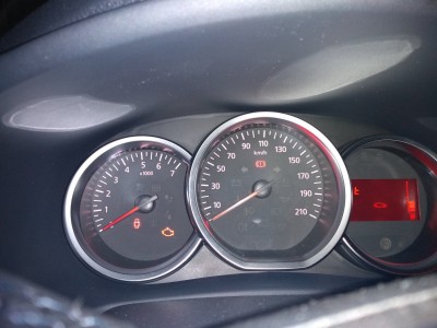

What about temperature display? I can only see the lines ...
effesse72
Model: Sandero II Stepway
Silnik: 1.5 dCi Blue 95
Wersja: Techroad
Dołączył: 30 Gru 2019
Posty: 35
Skąd: Italy

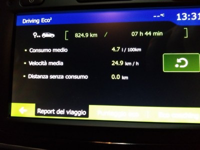

Wysłany: 2020-01-26, 13:36
Dear friend Dymek, I took those pictures only after connecting Pin 2 to +12Vcc and before reprogramming to Script 14, very sorry, I forgot to show them with explanations. Now I have to study hard for implement the Temp of Coolant of Engine (I don't like the little vertical bars) and 4WD Inclination Data, if it will be possible ;-)

I installed BIC module 283467937R in my car.
I connected the link like it :
I try to change the script with DDT4ALL, but i have NO DATA all time. I connected the Pin 3 to the +12v
This is the screen i have :
What can i do ? :)
